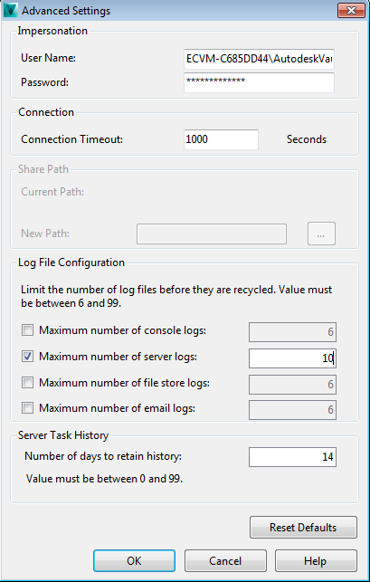

Access Advanced Server Settings
Configuration impersonation credentials, timeout limits, Share Paths, and log file preferences on the Advanced Settings dialog.
  1. Select Tools Administration.
  2. In the Administration dialog box, select the Advanced Settings tab.
  3. Click Settings.
    The Advanced Settings dialog displays.
