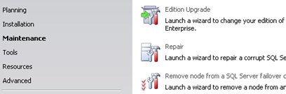

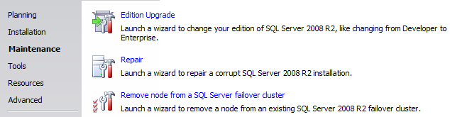

Method One
  1. Run the full version of SQL setup application.
  2. Select Maintenance > Edition Upgrade.

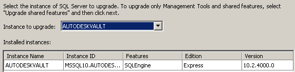

  3. Select the AutodeskVault instance and start the upgrade.
  4. After the upgrade is complete, apply the latest SQL service pack since this upgrade actually does not have on and it is not transferred from SQL Express.

  1. Launch Setup from the SQL Express 2008 R2 installation media. Select the Installation option, and begin the Upgrade wizard.
  2. Select the AutodeskVault SQL instance.
  3. Upgrade the instance by completing the wizard.

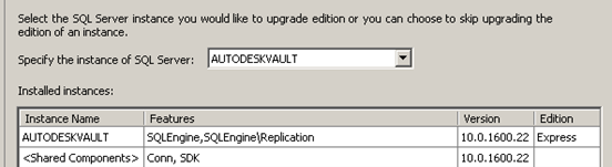

Upgrade MS SQL Express 2008 to Full MS SQL 2008
  1. Launch Setup from the Full SQL 2008 installation media. Select the Maintenance option, and begin the Edition Upgrade wizard.
  2. Verify version and or product key for Full SQL 2008. Proceed to the Select Instance window and choose the AutodeskVault instance.
  3. Upgrade the Instance. Once the instance has been upgraded, you can install the SQL Management Studio by returning to the "Installation" option and being the New SQL Server stand-alone installation or add features to an existing installation wizard.

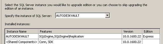

Upgrade MS SQL Express 2008 R2 to Full MS SQL 2008 R2
  2. Verify version and or product key for Full SQL 2008. Proceed to the Select Instance window, and choose the AutodeskVault instance.

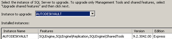

Upgrade SQL 2008 to SQL 2012
  1. Download SQL 2012 Express from http://www.microsoft.com, or insert your Vault installation media and go to <MEDIA>\\Support\Sql2012Express.
  2. Select Installation and begin the Upgrade from SQL Server 2005, SQL Server 2008, or SQL Server 2008 R2.
  3. Continue through the pre-installation process. Pre-request files and services are updated. Setup Support Rules are processed.
  4. On the Select Instance screen, select the AutodeskVault instance to upgrade and confirm instance settings. Click Next.
  5. Accept the default features on the Select Features screen by clicking Next.
  6. On the Instance Configuration screen, click Next.
  7. On the Ready to Upgrade screen, click Upgrade. Setup will complete and upgrade the AutodeskVault SQL instance to SQL 2012.

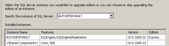

  1. Launch Setup from the Full SQL 2008 installation media. Select the Maintenance option and begin the Edition Upgrade wizard.
  2. Verify version and or product key for Full SQL 2008 and proceed to the Select Instance window and choose the AutodeskVault instance.
  3. Upgrade the Instance. Then, to install the SQL Management Studio, return to the "Installation" option and be the New SQL Server stand-alone installation, or add features to an existing installation wizard.
  4. Download and apply SQL 2008 SP1 if necessary.

  4. Select theAutodeskVault instance to upgrade, confirm instance settings.

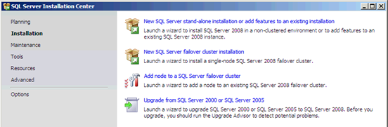

Upgrade from Full SQL 2005 to Full SQL 2008
  1. Select the Installation option and begin the Upgrade from SQL server 2000 or SQL Server 2005 Wizard.
  2. Continue through the pre-installation process. Pre-request files and services are updated. Setup Support Rules are processed.
  3. Select the AutodeskVault instance to upgrade, confirm instance settings.
    Note: If you do not see the "Database Engine Services" listed as a component to be migrated, you are not following an accepted migration path. Acceptable migration paths are listed here http://msdn.microsoft.com/en-us/library/ms143393.aspx
  4. Continue through Disk Space requirements, Upgrade rules, and Upgrade Process. Setup completes and upgrades the AutodeskVault SQL instance to Full SQL 2008.
  5. Verify that SQL 2008 SP1 is installed. If it is not, download and install it from http://www.microsoft.com.
