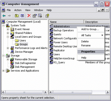

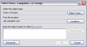

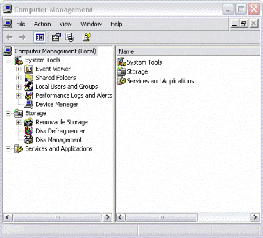

Add an account to the Windows Administrators group
