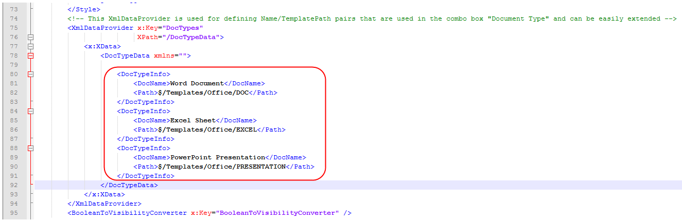

Vault Office Data Standard Templates
Three templates are pre-defined for the Vault Office client:
- Word Document
- Excel Sheet
- PowerPoint Presentation

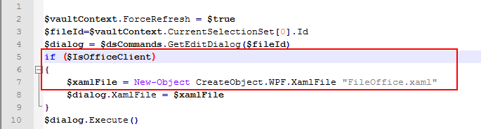

PowerShell Scripts and Properties
The XAML file is called within the PowerShell scripts
CreateFile.ps1 and
EditFile.ps1 when the variable
$IsOfficeClient is set, as shown below:
