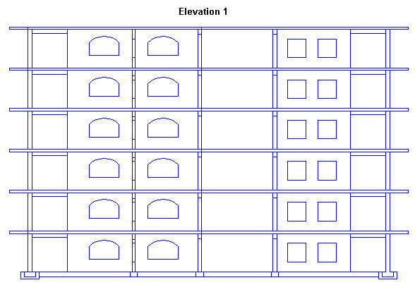

After a structure model has been edited, you can create an elevation view of the model at a user-defined location.
To create the elevation, select the option from:
In the drawing area, click to select points that define the elevation line, as shown.
The generated elevation view displays in the tree on the Positions tab of the Object Inspector dialog.
