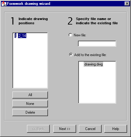

In the Formwork drawing wizard dialog:
An Autodesk AutoCAD Structural Detailing - Reinforcement macro runs and allows you to define parameters of necessary reinforcement of the selected element type.
After you define reinforcement parameters, the formwork drawing of the structure element and the generated reinforcement are opened in the Reinforcement module.
