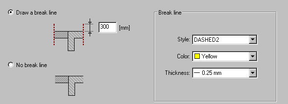

Breaks tab - use the options on this tab to define the display of breaks in the vertical section
Draw a break line - break lines will be displayed, and you can specify style, color, and thickness for the break line. You can also define the length of the line outside the structure model element
No break line - break lines will not be displayed.
