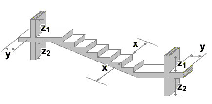

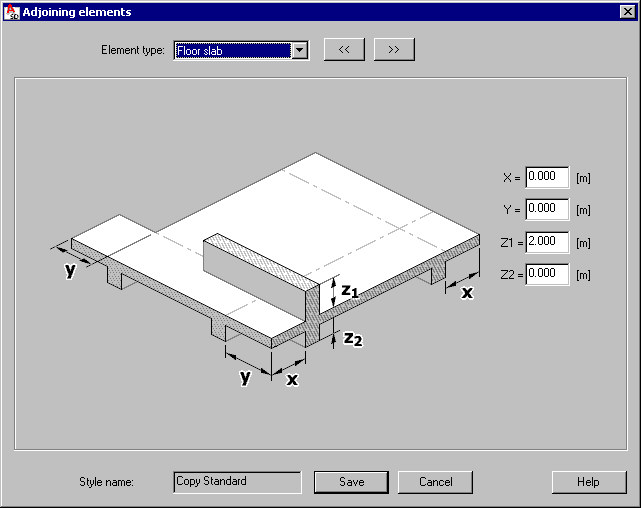

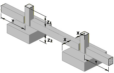

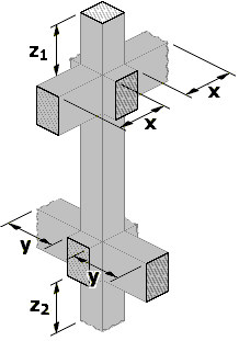

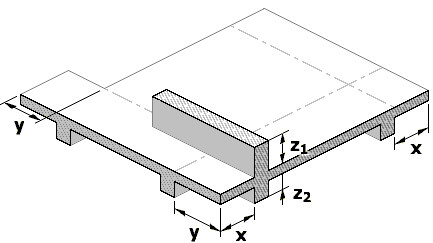

Use this dialog to define parameters for elements that adjoin the selected element type. These parameters determine the length of adjoining elements in a drawing.
To display the Adjoining elements dialog:
For Style name, enter a name for the component style, and click Save (this is only available when creating a style, not when modifying an existing style).
In the Adjoining elements dialog, specify dimensions that form the surroundings of a selected element type.
For individual element types, you can choose the following parameters:
| Element Type |
Preview |
Parameters |
| Beam |
X, Y, Z1, Z2 |
| Ground beam |
X, Y, Z1, Z2 |
| Column |
X, Y, Z1, Z2 |
Spread footing |
Z |

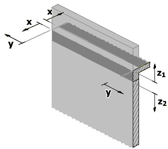

Wall |
X, Y, Z1, Z2 |

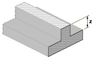

Continuous footing |
Z |
Floor slab |
X, Y, Z1, Z2 |

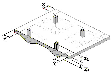

Raft foundation |
X, Y, Z1, Z2 |

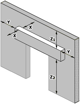

Lintel |
X, Y, Z1, Z2 |
Ring beam |
X, Y, Z1, Z2
Stairs |
X, Y, Z1, Z2 |
