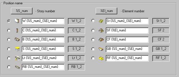

Position name
On the Job Preferences dialog, you can define a syntax for the name of the position created for each structure element during automatic positioning.
Note: For all structure elements (except spread footing, continuous footing, lintel, ground beam, and raft foundation), the position name must include a story number and an element number ({%El_num}). If the name does not contain both components, an error message displays.
Note: When you close the dialog, the software verifies the syntax, so that it is not possible to assign the same position to different elements.
A sample syntax: Wall {%S_num}_{%El_num}, depicted as Wall 2_3
where:
2 = the number of a building story
3 = the successive number of a wall on building story number 2.
After you define the syntax for a structure element, a preview of the name displays to the right of the definition.
