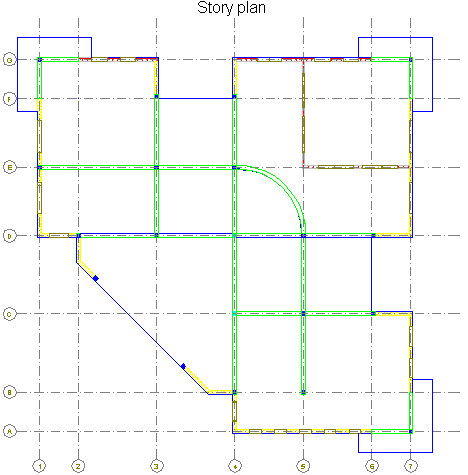

After a structure model has been edited, you can automatically create a projection of a selected story:
A new projection (plan) of a story is generated and displays in the tree on the Positions tab of the Object Inspector dialog.
After you name the story plan, right-click it, and click Activate. A drawing of the required story plan is created in the drawing area.
