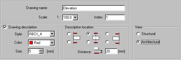

On the Job Preferences dialog, you can define parameters for an elevation view of a structure model.
Use the tabs on the dialog to define parameters:
Specify a drawing name and scale
Drawing description - select this in order to specify Style, Color, and Size
Description location - define the location of a description in a foundation plan drawing and a distance between the description and the view drawing.
View - select whether the elevation view will display as a structural model or an architectural model.
