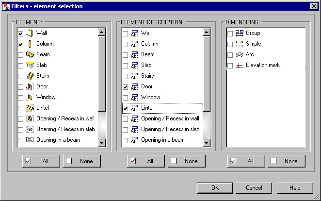

Using this option, you can define selection criteria for element descriptions and dimensions.
Open the Filters - element selection dialog from:
Select any combination of elements, element descriptions, and dimensions (the
symbol displays) to specify selection criteria.
To select all options in a field, click All. To clear the selection of all options in a field, click None.
