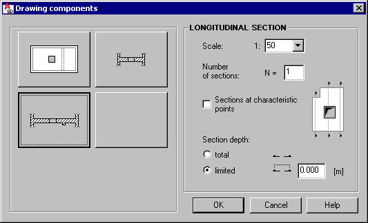

Using this dialog, you can specify which drawings will be generated (and in what scale) for selected types of structure elements.
To open the Drawing components dialog, click the icon that denotes a generated drawing in the Drawing layout dialog.
The contents of this dialog depend on the type of structure element for which it has been opened:
