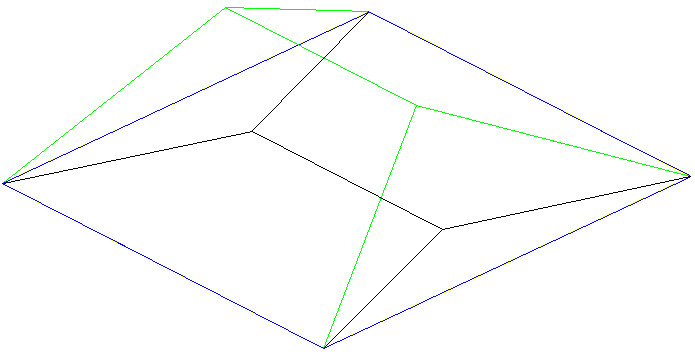

Using an inclined plane with a defined shape and slope, you can define multi-pitch roofs. Each roof surface needs to be defined separately. However, if the contour is symmetrical, only half of the roof surface needs to be defined.
Note: You can modify the contour of an inclined plane (projection) only on the plane (in 2D projection). You can modify the rotation angle (inclination of the plane) only in the 3D view.
An example of a multi-pitch roof created using this type of plane is shown.
