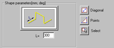

After selecting the 'goalposts' reinforcement, the Special reinforcement dialog displays:
To define a bar, specify the following:
While defining the 'goalposts' reinforcement, the following icons are available in the dialog:
