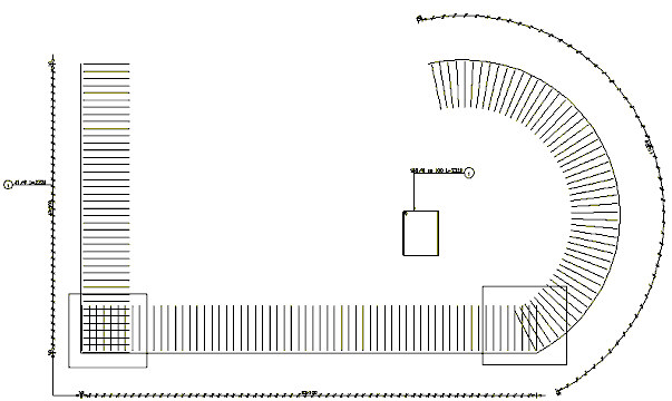

Distribution along the polyline
Linear distribution can be specified along a defined / selected broken line (polyline). Distributed reinforcing bars are placed perpendicular to the distribution line.
One reinforcement distribution zone is generated for each segment of a broken line. The distribution of reinforcement is described by one description line.
You can modify this reinforcement distribution type exactly as the zone distribution.
