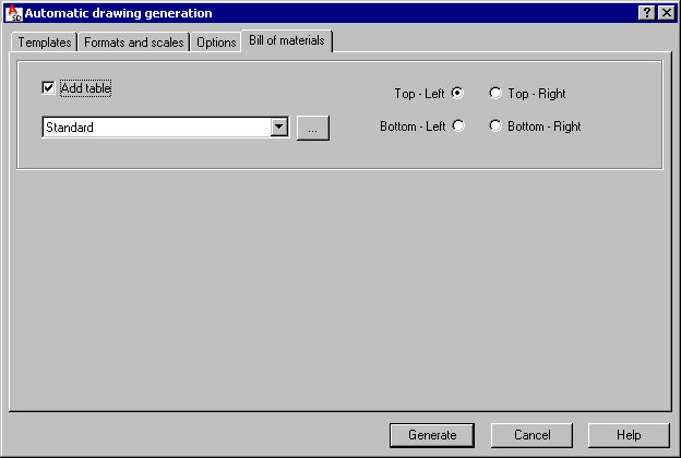

Bill of materials
On the Bill of materials tab of the Automatic drawing generation dialog, you can specify parameters for a bill of materials table.
If Add table is selected, a steel summary table will be added to the printout.
Specify the corner of the printout in which to locate the table:
Click the Browse (…) button to open an additional dialog where you can choose a template of a steel summary table.
