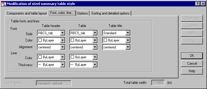

The image below displays the Font, color, line tab of the Definition/Modification of steel summary table style dialog.
Use the available options to specify:
- Font style, color, and alignment used in the table header and in all table cells
- Line thickness and color
- Font style, color, and alignment used in the table title (if Table with title is selected on the Options tab)
