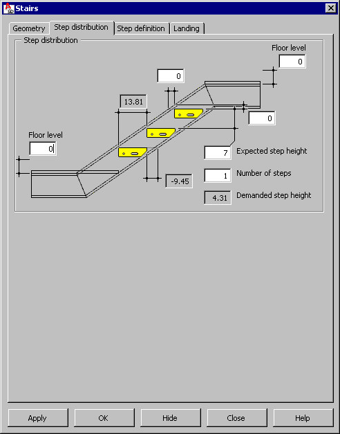

Use the options on the Step distribution tab to determine parameters of stair step distribution.
Define distribution of steps over the length of stairs:
- Floor level for both lower and upper landings
- Expected step height - this value is related to the number of steps
- Number of steps in the stairs
- Demanded step height and distance between 2 consecutive steps are read-only - these are linked with 2 user-defined parameters (number of steps and expected step height)
After you finish defining the distribution of steps, click the Step definition tab to display the Stairs - Step definition dialog.
