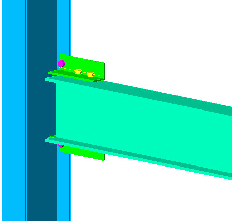

Using the Clip angle: to flange steel connection type, you can connect a column flange to a beam flange with either a bolted or a welded connection. The welded connection can be to the column, to the beam, or to both elements.
An example of the connection is displayed below.
