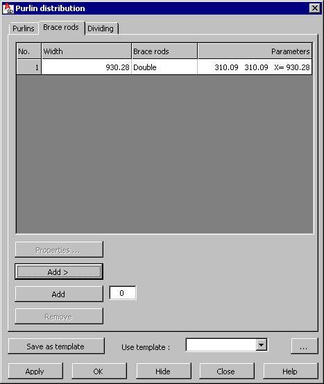

Use the options on the Brace rods tab to define additional bars (brace rods) between axes of roof girders.
In the Brace rods column, specify the rod shape:

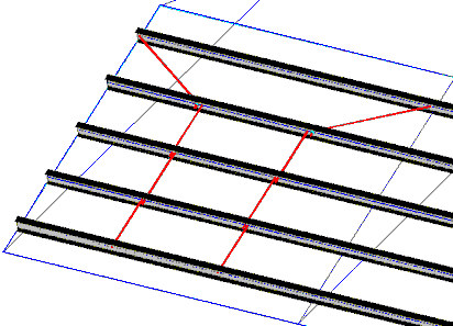

If n purlins are generated, the oblique bar of a brace rod is positioned between purlins n-1 and n. At the place where the oblique bar of a brace rod is connected with a purlin, the profile of the brace rod is perpendicular to the purlin web (the oblique bar is bent).
All remaining purlins (from 1 to n-2) are connected with each other by means of a straight bar.
Properties of a brace rod and details of the connection are available in a separate dialog; properties of brace rods are available after selecting one of them on the list (the brace rod is highlighted in the table) and pressing the Properties button. Parameters of a selected brace rod can be changed in the Properties of brace rods dialog.
Use the buttons at the bottom of the dialog:
