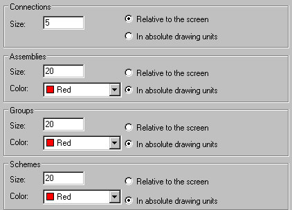

After you click Connections from the left pane of the Steel tab, the parameter options are as shown.
Specify display parameters for labels of defined connections (spheres), assemblies, and groups:
- Under Connections:
- Size - define the size of the connection symbol
- Relative to the screen - if this is selected, the size is expressed as a percentage
- In absolute drawing units - if this is selected, the size is expressed in units used in AutoCAD®
- Under Assemblies:
- Color - select a color for the assembly symbol
- Size - define the size of the assembly symbol
- Under Groups:
- Color - select a color for the group symbol
- Size - define the size of the group symbol
- Under Schemes:
- Color - select a color for the scheme symbol
- Size - define the size of the scheme symbol
