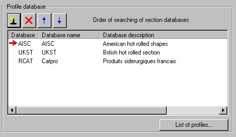

After you click Profiles from the left pane of the Project preferences dialog, the parameter options are as shown.
The Profile database list displays profile folders (databases) available in the current project. Click List of profiles to open the dialog in which profiles applied in a given project are displayed.
The following icons are at the top of the dialog:
- click this to open the dialog where you can select a database to be added to the list of available profile databases
- click this to delete a selected profile database
, - click these to move a database one position up or down on the list. The order is significant while searching through available profile databases.
