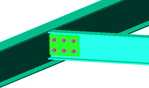

Using the shearplate - beam/beam web steel connection type, you can connect a secondary beam to the web of the main beam with either a bolted or a welded connection.
Allowable elements:
Straight profiles: all sections
Location of elements:
An example of the connection is displayed below.
