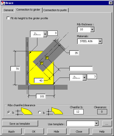

After you define the brace geometry use the Connection to girder tab to define parameters of the connection.
If Fit rib height to the girder profile is selected, a rib will be fitted to the space between the flanges of a girder profile.
A connection of the brace with the girder takes the form of a rib welded to the girder (along the whole girder height or only along its part), and the brace is fixed to this rib. To define this connection, specify the following parameters:
