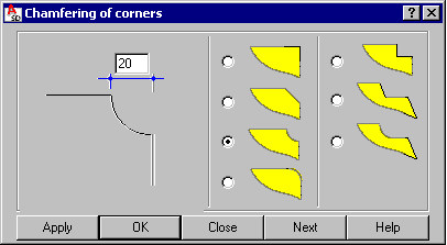

Use this option to chamfer plate corners.
To begin chamfering plates, open the Chamfering of corners dialog from:
In the drawing area, select a plate and the plate corner.
After you select the chamfer type, define chamfer dimensions (the number of available dimensions depends on the selected chamfer type). The chamfer is an active object, which means that it may be edited later (change of chamfer type, modification of parameter values). It is also possible to delete a plate chamfer.
Click Apply to modify chamfer parameters. Click OK to run the defined chamfer operation based on the parameters adopted and close the dialog.
After you click Close, the software carries out the defined operation without saving the changes made recently. Clicking Next starts chamfering of the next plate corner.
