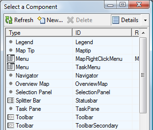

    • In the <Body> section, insert <div> elements to determine which components will appear on the template. Any HTML element with an ID that matches a component ID will be replaced with that component. For example, <DIV id=”Help”> will be replaced with the Help component. And <DIV id=”Toolbar”> will be replaced with a toolbar; the components that appear on this toolbar will be configured through Infrastructure Studio. To see the available IDs, click Attach Component while editing a flexible web layout in Infrastructure Studio.
      Components will be inserted in any DOM container object with a matching ID, not just in <DIV>s. So you can also use Jx methods, such as Jx.Panel and Jx.Layout to structure your page. For example, this will create an object that will have a legend inserted:
      var p1 = new Jx.Panel({label: 'Legend'});
      If there is no matching component for the ID, then when the user configures the flexible web layout, Infrastructure Studio will display an empty tab for it (one with no components added). The user can then add components to it through Infrastructure Studio. The ID will be used for the tab’s title, so use IDs that will help the user understand what he or she is configuring.

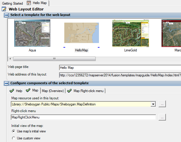

  6. Create a <TemplateInfo> XML file based on the ApplicationDefinitionInfo XML schema. (The XML schemas are installed in Autodesk Infrastructure Map Server 2015 \Schema (where Autodesk Infrastructure Map Server 2015 is the installation directory of the Infrastructure Map server, typically C:\Program Files\Autodesk\Autodesk Infrastructure Map Server 2015).
    • Name the file with the name of your template plus .xml, for example, HelloMap.xml.
    • Store it in the parent folder of the template. In other words, store it in web_server_extensions\www\fusion\templates\mapguide.
    • In the LocationUrl element, point to the location of your template’s index.html file.
    • In the PreviewImageUrl element, use the name of the preview graphic you created earlier.
    • Create a <Panel> element for each component (such as a toolbar) in the template. Each panel here will be shown as a tab when the template is configured in Infrastructure Studio.

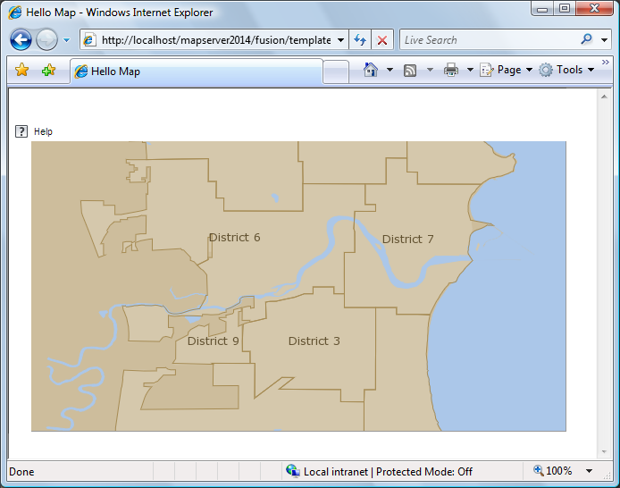

The template can now be used in Infrastructure Studio just like any of the default templates.
If you create a flexible web layout based on this template, it will look like this:
Note:
If you edit a template’s index.html file, right-click the preview image in Infrastructure Studio and choose Refresh to see the changes. If you change any of the other template files, such as modifying or adding a <Panel> element, also right-click on one of the panel tabs and choose Refresh Panels to update the panel definitions.
