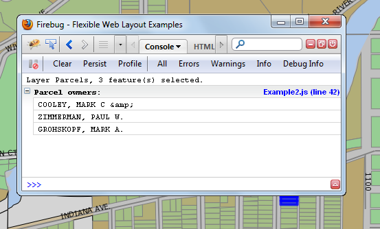

Example 2 is a widget that is designed to be called as a command from a menu. It requires Mozilla Firefox 3.6 and the Firebug extension because it writes to the Firebug console. It uses the following files in the folder WebServerExtensionsInstallDir\www\fusion:
This example writes information about the currently selected parcels to the Firebug console. For more information about selections, see The Map Component and Working With Selections.

Example2.js combines these concepts to write the owner names of selected parcels to the Firebug console.
