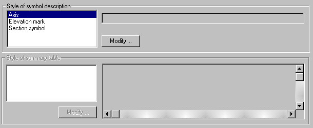

After selecting the Symbols -> Styles option from the Job preferences dialog, the following options display:
The dialog displays basic information about the currently-defined styles of symbol description (axis, level and section).
The upper part of the dialog includes a description of styles for the following symbols:
After selecting an appropriate style from the list (e.g. the elevation mark symbol - the name is highlighted), a description example displays based on the settings of the description style.
To modify a style:
Click Modify. The dialog used for defining styles for axes, elevation marks or sections opens; it enables direct modification of a selected type of reinforcement.
The bottom part of the dialog displays styles of a summary table. Once an appropriate table style is selected, an example table for the element indicated on the list, is displayed. Click Modify to open the dialog used for defining table styles.
