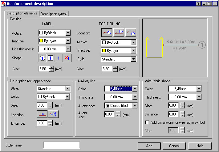

On the Description elements tab of the Reinforcement description (wire fabric shape) dialog, you can define parameters such as colors, line thickness, font size, and label shape for a description.
The options included in the Position field refer to a label and the number that the label contains (see the drawing below).
Under Position, specify Label parameters:
Specify Position Number parameters:
The active position referred to here is specified on the Reinforcement description dialog (see the drawing below). If Active is selected for a given position, you choose a color from the Active list. If Active is not selected, you choose a color for this position from the Not active list.
The options under Description text appearance define a description placed between a position (label) and the described wire fabric:
Under Auxiliary line, define parameters of a line that connects a position with reinforcement:
Under Wire fabric shape, define parameters for a symbolic shape of the described wire fabric:
Dimensions for wire fabric symbol - when you select this, the wire fabric description includes a wire fabric symbol, and you can specify the size of individual segments of a wire fabric bar.
