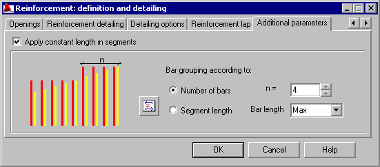

Access this option by selecting the Additional parameters tab in the Reinforcement: definition and detailing dialog. The following dialog displays:
You can select the Apply constant length in segments option in the above dialog.
The option allows for automatic bar distribution in case one or more edges is inclined. The option allows to apply so-called constant length in segments, i.e. grouping the bars according to the rule defined in the dialog, and assigning constant length to them in a given group.
Bars can be grouped in two ways:
Moreover, there is a possibility to select the maximum or the minimum bar length in a given group for both types in the Bar length field.
Additionally, the direction of starting the bar group definition can be changed by means of the
icon.
