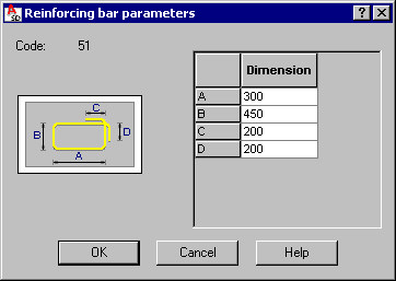

There is also another method for defining bars. Once the Shape parameters… button is clicked, the additional dialog displays, and a table containing dimensions of individual bar segments is available. After determining bar dimensions, a completed bar may be added to a formwork.
The above dialog contains a table that displays dimensions of bar segments.
The field with a shape code is filled out automatically depending on a typical shape selected.
Both modes of reinforcement definition are synchronized with each other; both definition modes can be used alternately.
