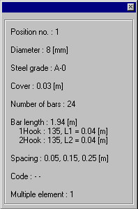

Use this option to display basic information about a reinforcing bar or distribution. The option is available:
When selected, the cursor changes to a ‘cross’. When the cursor is located close to a reinforcement position (reinforcing bar, reinforcement distribution) presented in a drawing, a small dialog displays, and information concerning the selected reinforcement is presented. If any information about reinforcement is inaccessible (e.g. position no. or spacing), then a '---' symbol displays. An example of reinforcement information is shown below.
