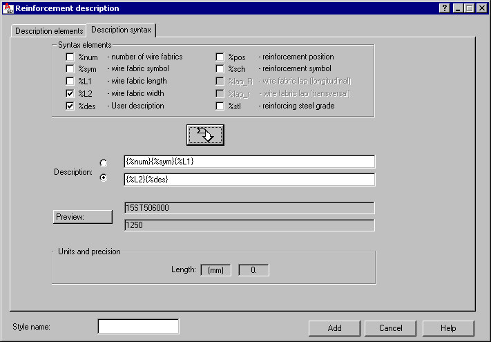

On the Description syntax tab of the Reinforcement description (wire fabric shape) dialog, you can define syntax of a description of a wire fabric shape.
Under Syntax elements, select components and move them to the Description field (by clicking the arrow under the element list), where you can arrange variables with user-defined text and symbols.
The Preview field displays a description of the wire fabric shape that results from the defined syntax. This description is based on number values that have been saved as fixed, and updates with changes in preferences (change of unit or precision). Note: units are not displayed in a preview.
Under Units and the precision, the software displays the diameter, length, and spacing data applied while displaying a given value.
Variables included in a wire fabric description:
%num - number of wire fabrics
%sym - wire fabric symbol
%L1 - wire fabric length
%L2 - wire fabric width
%des - user description
%pos - reinforcement position
%sch - reinforcement symbol
%lap_R - wire fabric lap (longitudinal)
%lap_r - wire fabric lap (transversal)
%stl - reinforcing steel grade
