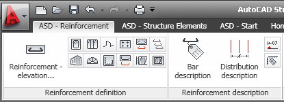

Ribbon
The ribbon is an element of the user interface which replaces the traditional menu and toolbars and allows easy managing and adjusting the workspace.
The ribbon consists of several panels, grouped on tabs that are designated by task or subject. The ribbon panels include many commands that have been on toolbars and in dialogs so far, such as icons, drop-down lists, sliders, text fields and other elements characteristic of a given tab. Using the ribbon, you do not have to display many toolbars; thus the application displays fewer functions and increases the allowable workspace placing the whole interface on a small area that can be anytime shown or hidden.
The ribbon displays automatically when a drawing is created or opened using the ASD Reinforcement workspace. You can display the ribbon manually using either of the following methods:
You can customize the ribbon, that is you can add, delete and modify positions of panel elements, in the Customize User Interface (CUI) editor window. Open this editor using either of the following methods:
Note: You can display the ribbon horizontally, vertically or as a floating palette.
Using the editor you can also switch between workspaces (such as the classic workspace without the ribbon). To do it, select the Customize tab > Workspaces and select Set current from the context menu.
To change between workspaces, you can also use the Workspace Switching icon at the bottom right corner of the screen.
