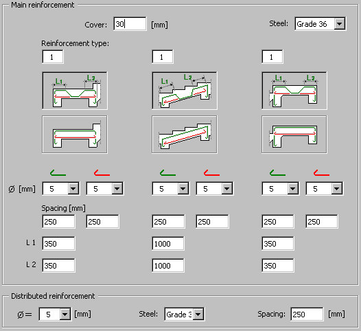

After defining the stair reinforcement dimensions, click Next. The following dialog displays:
The upper part of the dialog displays the following parameters:
Below are presented schemes (shapes) of main reinforcement for:
lower landing - types of reinforcement:
type 1 -
type 2 -
type 3 -
type 4 -
upper landing - types of reinforcement:
type 1 -
type 2 -
type 3 -
with additional reinforcement, if needed
stairs' foundation - types of reinforcement:
type 1 -
type 2 -
upper landing - types of reinforcement - the same as above
For every reinforcement type (shape) the following parameters should be specified:
In the lower part of the dialog, the following parameters of distributed reinforcement are specified:

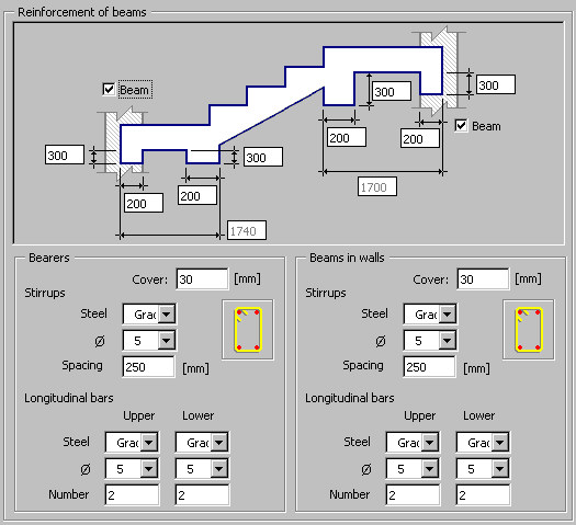

In the case of stairs with bearers, the definition of reinforcement is divided into the following two stages:
Bearers are always generated; beams in walls are generated only when the Beam option is selected.
The following reinforcement parameters are defined for beams in walls and bearers:
- steel grade
- stirrup diameter
- stirrup spacing
- steel grade
- stirrup diameter
- number of reinforcing bars.
The upper part of the dialog includes parameters of the main reinforcement of stairs:
Below are provided schemes (shapes) of the main reinforcement for:
type 1 -
type 2 -
type 1 -
type 2 -
type 1 -
type 2 -
The following parameters are specified for each type (shape) of reinforcement:
The following parameters of distributed reinforcement are specified in the lower part of the dialog:
