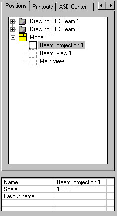

The Positions tab presents a list of defined views containing name, scale and name of the printout layout including a given view as shown below.
The icon of a document included on the list is presented as follows:
active view
inactive view.
If the icon of a view provided on the list is shown in bold, it means that it is an active view.
Access the context menu by right-clicking the Positions tab. The menu contains several options which allow performing operations on selected positions:
