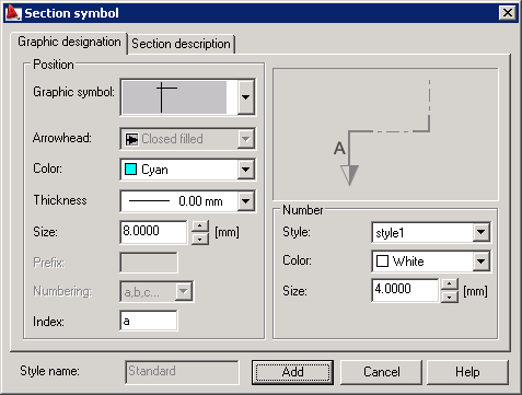

Graphic designation
After selecting the Graphic designation tab from the Section symbol dialog, the following dialog displays:
The Position field holds parameters of a symbol representing the section of an RC structure element in a drawing: graphic symbol type, arrowhead of the section symbol, symbol color, size and thickness of a line in the symbol; besides, it is possible to select numbering of the section symbol: with letters: A, B, C, with numerals: 1, 2, 3, with numerals: I, II, III or by determining any other designations (after the Define option is selected). An example of a section designation is displayed below.
The options provided in the Number field refer to a section description. The following parameters can be set: font style, color and size.
