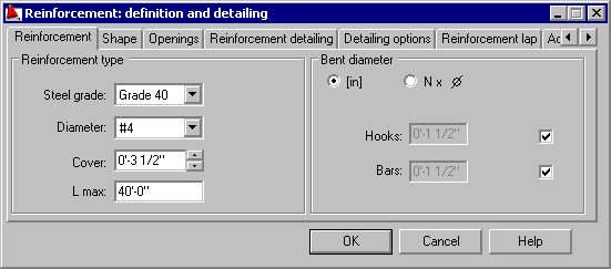

Access this dialog by selecting the Reinforcement tab from the Reinforcement: definition and detailing dialog. The following dialog displays:
Specify the following parameters:
- steel grade
- reinforcement diameter
- reinforcement cover
- maximum length of reinforcing bars
To ensure that all generated bars or hooks in the distribution have the same bent diameters and equal values are entered in the Bars and/or Hooks fields, select the option (
) next to one and/or both these fields to block values.
