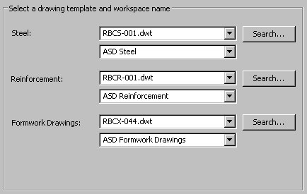

Select this option to use the basic parameters of Autodesk AutoCAD Structural Detailing. There are several ways to access the option:
In the AutoCAD® Options dialog, on the Structural Detailing > General Settings tab you can select a drawing template for Autodesk AutoCAD Structural Detailing modules and workspace names (such as ASD or ASD Classic).
Templates assigned to individual countries are shown in the following table:

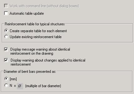

The Structural Detailing tab in the Options dialog is divided into two main parts:
After selecting Reinforcement in the selection tree, the dialog displays the following options:
