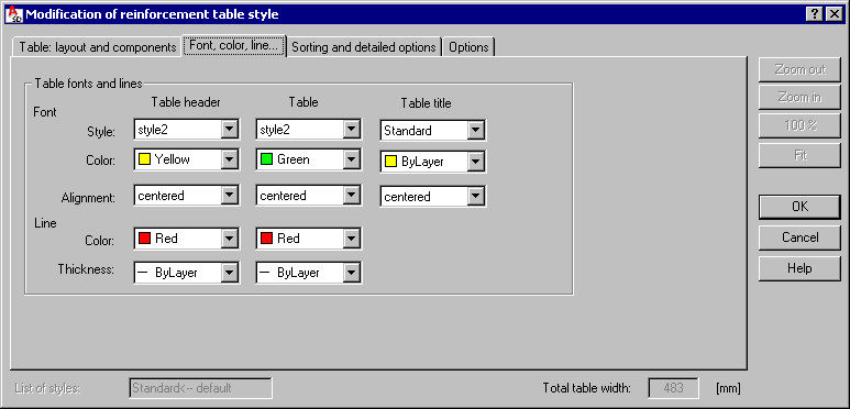

Once the Font, color, line tab is selected in the Definition/modification of reinforcement table style dialog, the following displays:
The following options are available:
- Determine a font used in the table (in the table header and all table cells): style, color and alignment of table header and texts in table cells
- Select table lines: thickness and color
- Define a font used in the table title (if the Table with title option is activated on the Options tab): style, color and alignment of table title.
