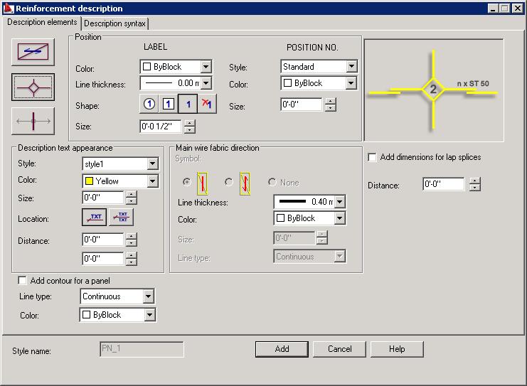

On the Description elements tab of the Reinforcement description (wire fabric distribution) dialog, you can define parameters such as colors, line thickness, font size, and label shape for a description.
There are the following ways to display a wire fabric in drawings:
Options in the dialog are specific to a selected type of presenting a wire fabric.
The options included in the Position field refer to a leader (label) and the number that the label contains.
Under Position, specify label parameters:
Specify position number parameters:
The options under Description text appearance define a description placed behind a reinforcement position:
Under Main wire fabric direction, select a symbolic shape of the main wire fabric direction:
When a symbol is used, define symbol parameters:
If you select the Add dimensions for lap splices option, descriptions include dimensions of lap splices.
At the bottom of the dialog is the option for simplified presentation of wire fabrics - Add contour for a panel. After you select this option, additionally, a contour is drawn for a panel (slab). Specify a line type and color for this contour.
The Distribution line field has options for the group presentation of wire fabrics:
