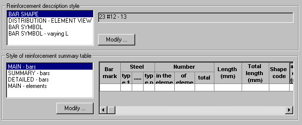

This dialog provides basic information about the styles currently defined and relevant reinforcement or table to which these styles apply. Access the dialog by selecting Bars -> Styles from the Job preferences dialog. The dialog includes additional options as shown below.
The top part of the dialog includes styles of reinforcement descriptions with reinforcement division into categories considered. Once an appropriate reinforcement category is selected from the list (the category is highlighted), an example description displays based on the settings of the reinforcement description style.
To modify a style:
Click Modify. The dialog used for defining styles of reinforcement description opens; it enables direct modification of a selected type of reinforcement.
The bottom part of the dialog displays the table styles applied to prepare a reinforcement table. Once an appropriate table style is selected, an example reinforcement table for the element indicated on the list, is displayed. Click Modify to open the dialog used for defining table styles.
