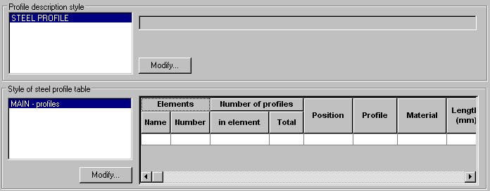

This dialog provides basic information about the styles currently defined and relevant reinforcement or table to which these styles apply. Access the dialog by selecting Profiles -> Styles from the Job preferences dialog. The dialog includes additional options as shown below.
The top part of the dialog includes styles of steel profile descriptions with reinforcement division into categories considered. Once an appropriate reinforcement category is selected from the list (the category is highlighted), an example description displays based on the settings of the steel profile description style.
To modify a style:
Click Modify. The dialog used for defining styles of steel profile description opens; it enables direct modification of a selected type of steel profile.
The bottom part of the dialog displays the table styles applied to prepare a steel profile table. Once an appropriate table style is selected, an example steel profile table for the element indicated on the list, is displayed. Click Modify to open the dialog used for defining table styles.
