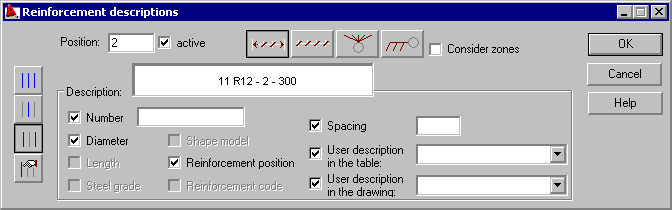

These options are used to enable final selection of reinforcement description and distribution (by deselecting active variables that are initialized based on the defined syntax). After completing reinforcement definition and determining its distribution within the defined region, the following dialog displays:
The following options are provided in the dialog:
- The Active option provides information about the current reinforcement position and allows you to avoid double or multiple calculation of the same reinforcement while preparing the reinforcement table.This part of the dialog also contains the Consider zones options; if this option is selected, then individual zones of reinforcement distribution are described separately, however, if this option is cleared, all zones of reinforcement distribution are described.
- Icons used to define the method of presenting distribution:
- all elements are presented in a drawing of given reinforcement distribution
- only the middle representative of distribution in a given zone is presented (the remaining elements are not visible)
- only extreme elements of distribution in a given zone are presented (the remaining elements are not visible)
- indicates graphically distribution elements to be presented
- The fields: User description in the drawing and User description in the table allows you to add a reinforcement description; the description displays in drawings (included in bar descriptions in the drawing) and in the table (included only in the reinforcement table); the added text is added to the selection list; text taken from the library of standard descriptions may also be applied. These descriptions assume the style of the text describing the reinforcement. The user description displays in several lines; then the mechanisms accessible in AutoCAD® are applied. The user description together with an extension line and a label make up one object. Such an object can be translated or rotated using the Explodeoption.
A description is assigned to the defined reinforcing bar distribution sector by sector (a sector is a contour part automatically recognized by the program as a part with similar distribution).
