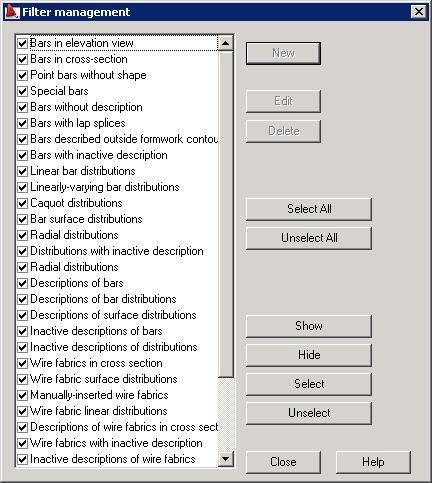

Clicking
in the Object Inspector dialog opens the Filter management dialog as shown below.
The dialog includes all defined filters and the following buttons:
- Show, Hide, Select - they work the same as in the Object Inspector dialog (see the description above)
- Unselect - clicking this button switches off selection of chosen elements (e.g. radial distributions or bar descriptions) in the drawing
- Select All / Unselect All - clicking this button selects / switches off selection of all elements (filters) provided on the list
- New, Edit, Delete these options are not available in the current program version.
