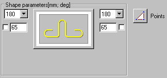

Once any of the transport reinforcement types is selected, the Special reinforcement dialog displays:
To define a bar, the following should be specified:
appears). The edit field becomes inaccessible. If you modify parameters (length or diameter) of a bar with locked hook length, the hook length does not change. While defining this reinforcement type, only one icon
(Points) is available in the dialog. After selecting this icon, the dialog closes, and the cursor assumes the shape of a cross (see the ACAD command 'line'). During definition of transport reinforcement, the user should specify three or four snap points of this reinforcement type.
Select bar attachment point
Select second bar point
Select bar node
If need be, fourth point
Cover / Side / Mirror
