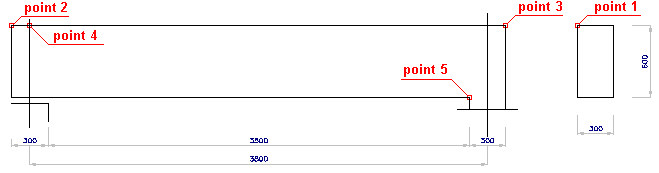

The following drawing illustrates the definition of transversal reinforcement in the cross section of the beam. For definition of the beam contours the Formworks - Beam macro has been used.
To define transversal reinforcement of the RC beam, follow the steps below:
Click Insert in the Formworks - Beam dialog, and indicate the location of the beam formwork in the drawing.
Click
(Pick point), located on the right side of the dialog.
In the drawing of the beam formwork, indicate a point within the beam cross section and point 1 that determines the position of stirrup hooks.
Accept the default reinforcement description proposed in the Reinforcement description dialog by clicking OK.
Indicate the position of the reinforcement description by clicking Enter or right-clicking the Enter option from the context menu.
The reinforcement in the beam cross section has been defined. To define the transversal reinforcement distribution along the beam length, follow these steps:
Indicate the start distribution point (point 2 in the drawing presented at the beginning of the example) and the end distribution point (point 3 in the drawing presented at the beginning of the example).
Indicate the points of the zone beginning (point 4 in the drawing presented at the beginning of the example) and the zone end (point 5 in the drawing presented at the beginning of the example); click Enter.
Accept the default reinforcement distribution by clicking OK.
Adopt the following parameters of description of the reinforcement distribution
Indicate the location of the reinforcement description in the drawing by clicking Enter, or right-clicking the Enter option from the context menu.

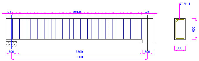

The defined transversal reinforcement with its distribution along the beam length is illustrated below.
