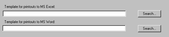

After you select Templates from the selection tree located in the left part of the Table printout manager dialog, the options shown below display on the right.
You can select templates for printing tables to the following programs:
In the edit fields, specify file names with a full access path. After you click Search, you can specify a template file from the computer hard disk.

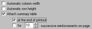

In Autodesk AutoCAD Structural Detailing - Reinforcement, there are additional options available for printouts to MS Word®. They let you insert an additional summary table that includes information about the reinforcement (if Attach summary table is selected). You can set the table either at the end of the entire printout or for several successive reinforcements on a page.
Additional options:
