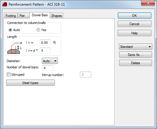

The Dowel Bars tab allows you to define the generation method of dowel bars.
Select RC Design
Provided reinforcement layout, and then create a new RC element or open an existing one.
Reinforcement Pattern.
(Reinforcement Pattern).
If the Auto option is selected, the program generates dowel bars in the case of:
Defines the dowel length.
Enter an absolute value or a value dependent on the bar diameter. Code requirements always take precedence over user-defined values.
Defines the diameter of dowel bars.
If the number of dowels bars equals
The maximal number of dowels is limited by the allowable distance between bars.
Surrounds the dowels with stirrups
Define the number of stirrups on dowels.
Placement and position is automatically generated and can be modified in the graphic viewer.
